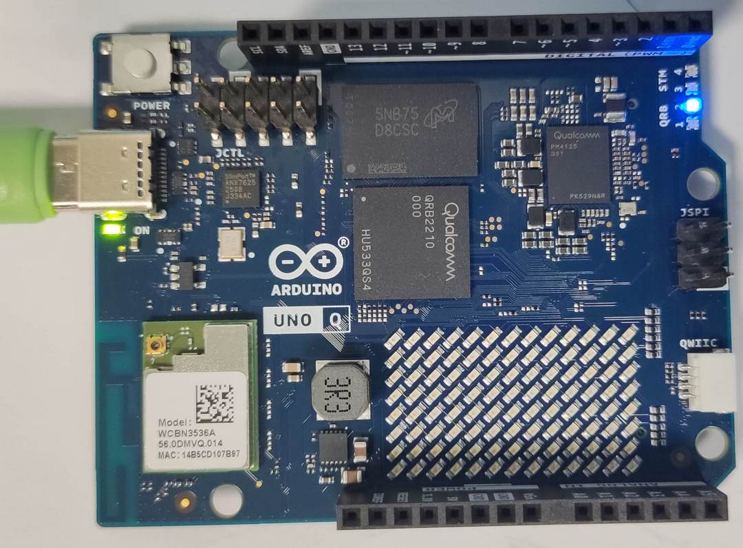

硬件连接
这里采用 SSH 远程控制,使用 Type-C 数据线供电并 WiFi 联网即可。

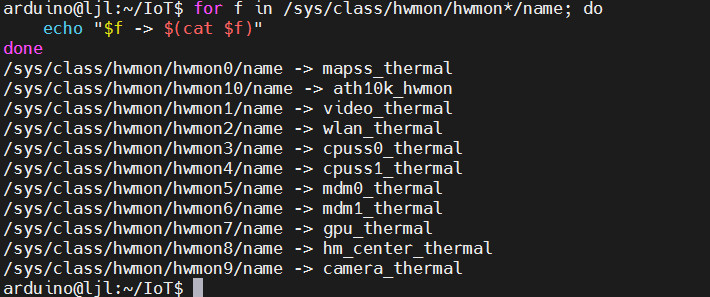

板载系统为 Debian 13,温度传感器挂在 hwmon (hardware monitoring) 子系统。
终端执行如下指令,获取 hwmon 所在路径
for f in /sys/class/hwmon/hwmon*/name; do
    echo "$f -> $(cat $f)"
done
回复 /sys/class/hwmon/hwmon0/name -> mapss_thermal 即为 SoC 主域温度;
对应文件路径 /sys/class/hwmon/hwmon0/temp1_input
若需要监控其他区域的温度,将路径中的 hwmon0 改为对应序号即可。

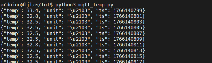

效果
终端执行 python3 soc_temp_mqtt.py 运行程序,终端打印 MQTT 报文

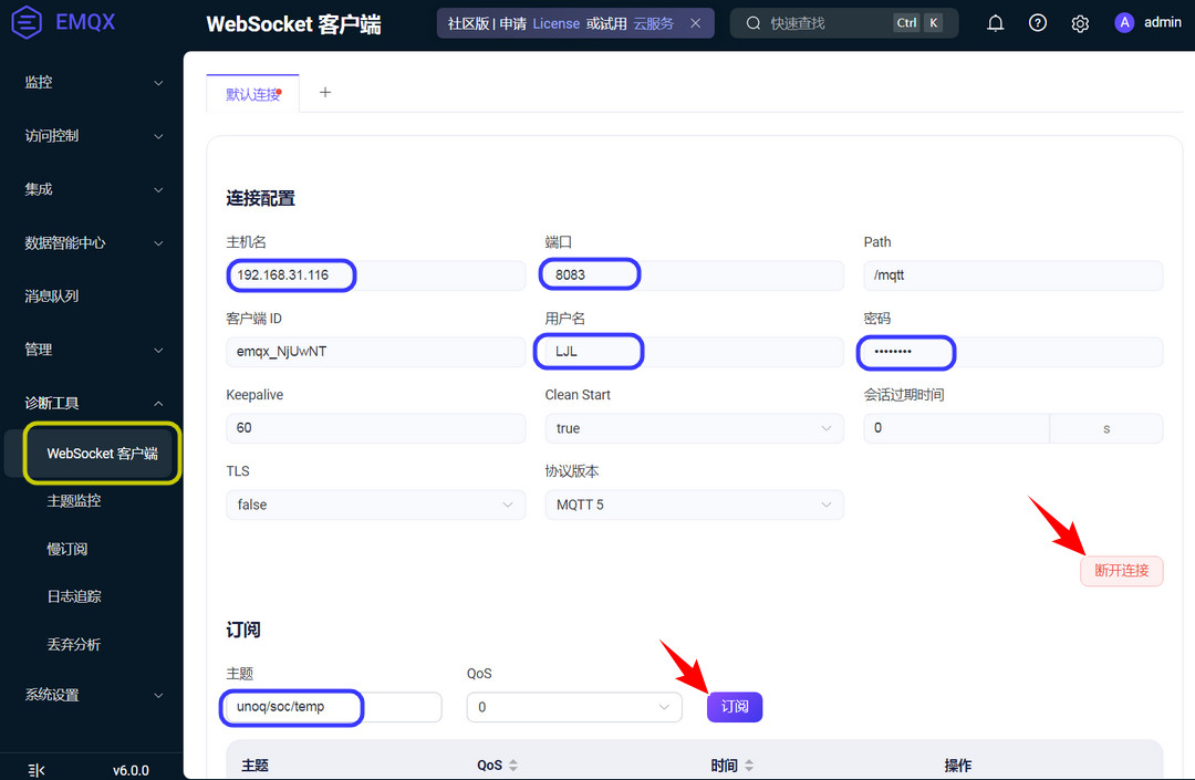

消息订阅
浏览器访问 http://192.168.31.116:18083 进入 EMQX 控制终端;
左侧工具栏 - 诊断工具 - WebSocket 客户端
填写 ip 地址、端口、用户名、密码,点击 连接 按钮;
订阅 面板中填写主题 unoq/soc/temp
在下方消息框立刻收到 SoC 温度消息;

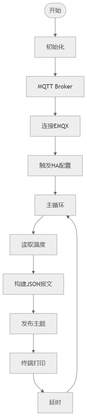

这里将 SoC 温度数据通过 MQTT 协议上传至 Home Assistant 平台,包括流程图、代码、效果演示等。
流程图

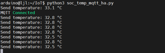

终端执行 touch soc_temp_mqtt_ha.py 新建程序并添加如下代码
#!/usr/bin/env python3
import time, json
import paho.mqtt.client as mqtt
# ----------- parameters -----------
MQTT_HOST = "192.168.31.116"
MQTT_PORT = 1883
MQTT_USER = "xxx"
MQTT_PASS = "xxx"
CLIENT_ID = "unoq_soc_temp"
DISCOVERY_PREFIX = "homeassistant"
NODE_ID = "UNO_Q"
OBJECT_ID = "soc_temp"
TEMP_PATH = "/sys/class/hwmon/hwmon0/temp1_input"
SEND_INTERVAL = 2
STATE_TOPIC = f"{DISCOVERY_PREFIX}/sensor/{NODE_ID}/{OBJECT_ID}/state"
CONFIG_TOPIC = f"{DISCOVERY_PREFIX}/sensor/{NODE_ID}/{OBJECT_ID}/config"
def read_temp():
    with open(TEMP_PATH) as f:
        return round(int(f.read()) / 1000, 1)
def on_connect(cli, *_):
    config = {
        "name": "SoC Temp",
        "state_topic": STATE_TOPIC,
        "unit_of_measurement": "°C",
        "device_class": "temperature",
        "value_template": "{{ value_json.temperature }}",
        "unique_id": f"{NODE_ID}_{OBJECT_ID}",
        "device": {
            "identifiers": [NODE_ID],
            "name": "Arduino UNO Q",
            "model": "Arduino UNO Q",
            "manufacturer": "Qualcomm"
    cli.publish(CONFIG_TOPIC, json.dumps(config), retain=True)
    print("MQTT Connected")
def main():
    client = mqtt.Client(mqtt.CallbackAPIVersion.VERSION2, client_id=CLIENT_ID)
    client.username_pw_set(MQTT_USER, MQTT_PASS)
    client.on_connect = on_connect
    client.connect(MQTT_HOST, MQTT_PORT, keepalive=60)
    client.loop_start()
    while True:
        try:
            temp = read_temp()
            client.publish(STATE_TOPIC, json.dumps({"temperature": temp}), qos=1)
            print(f"Send temperature: {temp} °C")
        except Exception as e:
            print("Read/send failed:", e)
        time.sleep(SEND_INTERVAL)
if __name__ == "__main__":
    main()
效果
终端执行 python3 soc_temp_mqtt_ha.py 运行程序,终端打印发送的实时温度数据

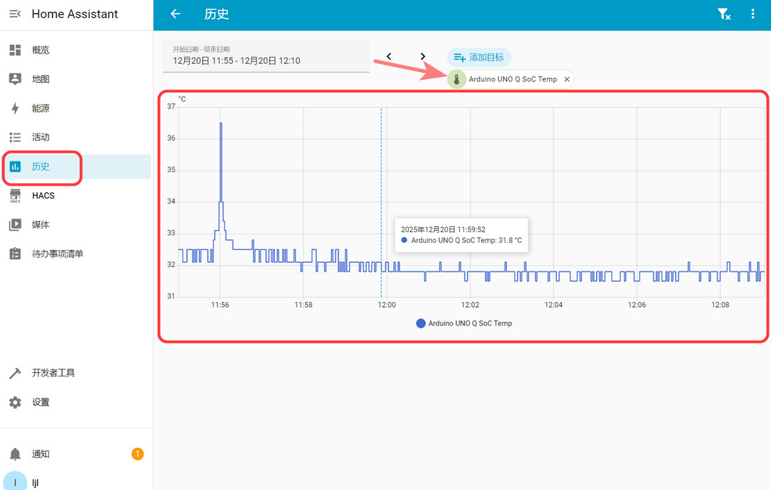

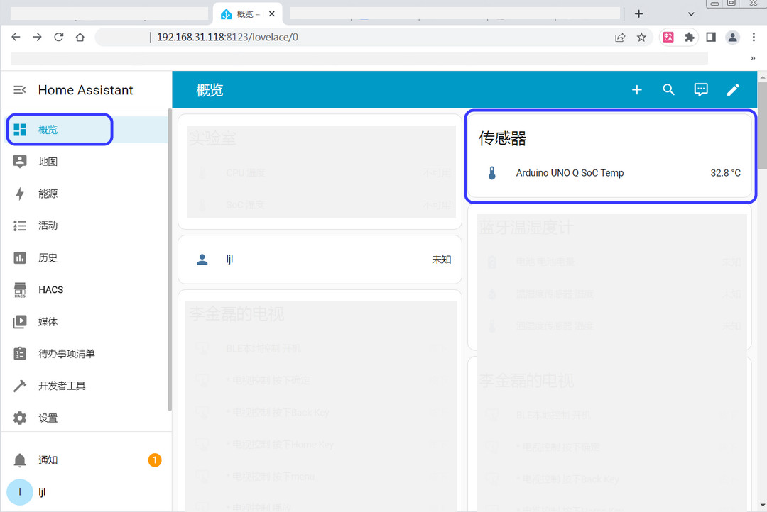

进入 HA 主页,刷新概览界面,可自动识别到 MQTT 传感器设备
点击卡片进入详情,可查看历史数据

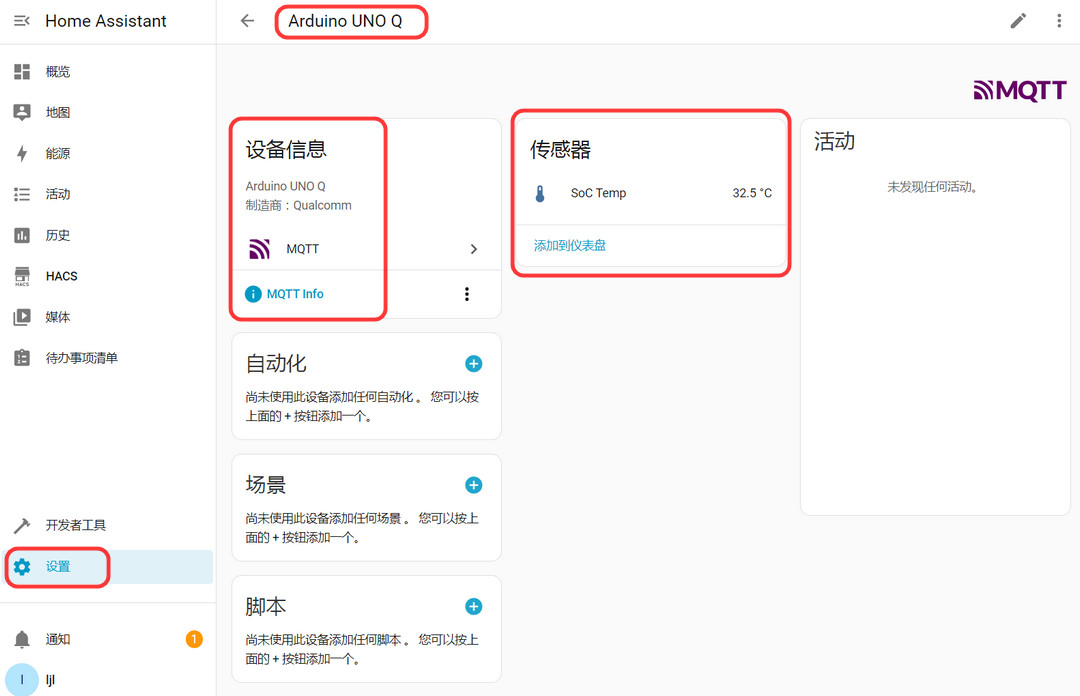

进入 设置 - 设备与服务 - 打开上方的 设备 标签页,点击目标 Arduino UNO Q 设备,可查看详细信息
