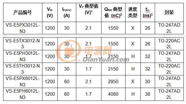

器件规格表:
微信截图_20190417131321
1IF = 额定电流, TJ = 125 °C
2TJ = 125 °C, IF = 40 A, VR = 400 V, dIF/dt = 600 A/ms
3TJ= 25 °C IF = 1 A dIF/dt = 100 A/μs, VR = 30 V
